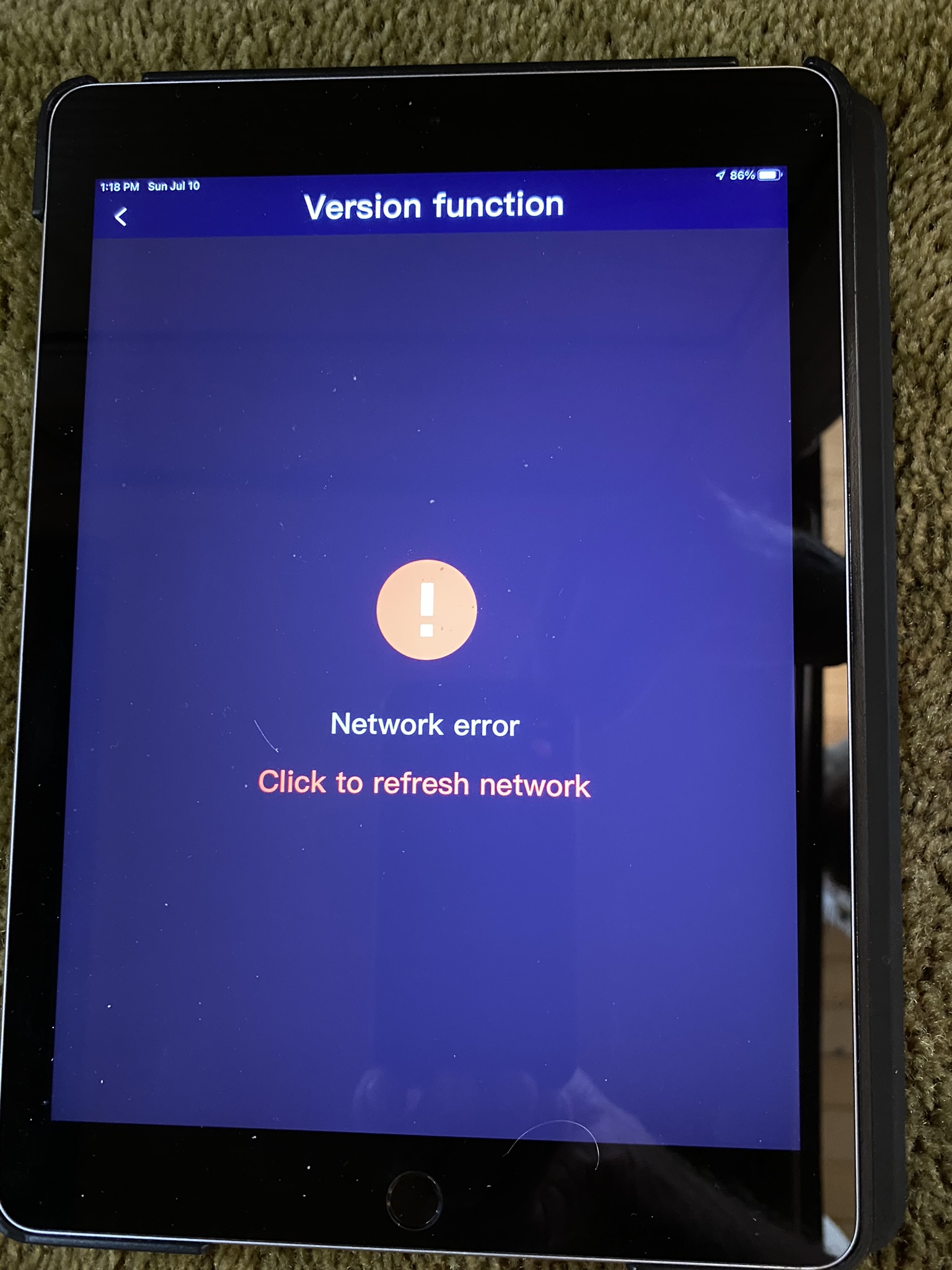

What does this message mean on my fifish v6 under Version Function? My iPad is connected to the RC, all functions under Device Check check good and the camera works.
Click where to refresh?????

It's hard to find answers.
The screen shot above is from the fifish app on my iPad under the "HELP" menu while connected to the RC, it askes for the iPad to be connected to the internet. It now requires the iPad to be disconnect from the RC WIFI and connect to the internet WIFI this will provide the content of "VERSION FUNCTION" (the version of Firmware ) and also "FIRMWARE UPDATE" if a new version is available and more.
Next step is to reconnect to the RC's WIFI to operate the RC.
I don't know of a way to keep both connections to the internet and the RC at the same time???
Maybe some one can tell me.

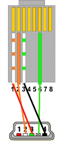

USB-LAN
I identified the contacts for the DIY adapter.
Connect to PC or Smartphone/tv-box without WiFi 5G.

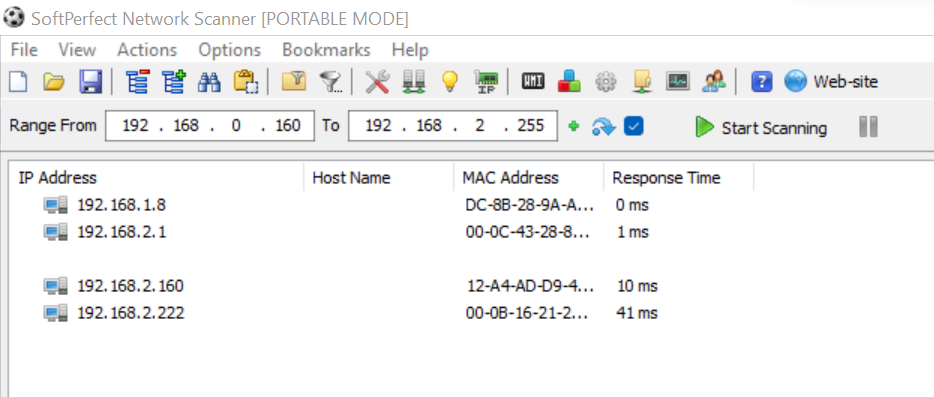

rtsp://192.168.2.160/livestream/12 - video stream witch VLC player or MediaPleerClassic

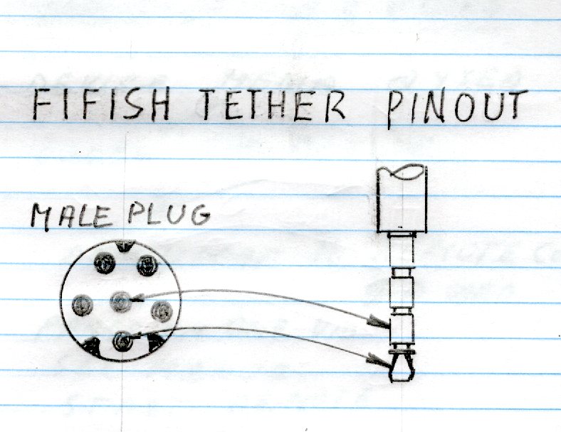

This also may be of help to determine if the tether cable is functioning correctly by doing a continuity test on the cable.

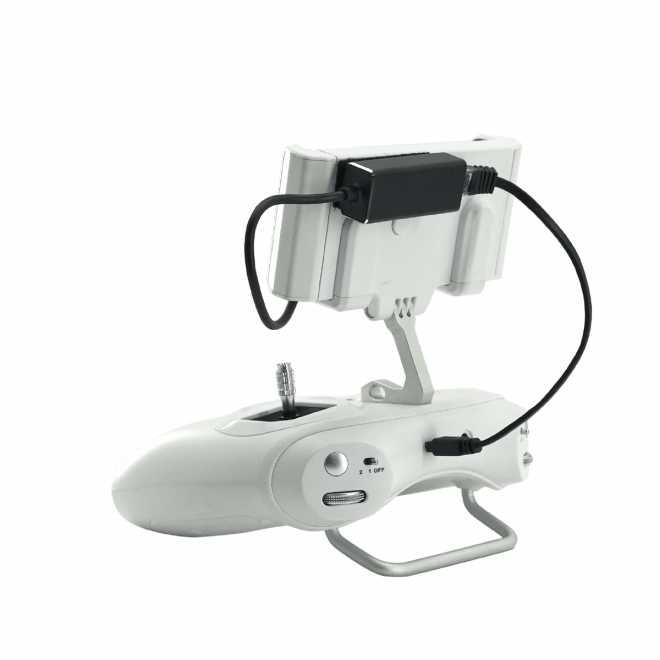

https://store.qysea.com/lightning-to-ethernet-adapter.html
I will order it and try it.
Just received an update to my order "lightning to Ethernet adapter " I was informed that they didn't add the shipping cost $59.- to the $29.- order. I probably will cancel the order since my WIFI connection works and the shipping form China will probably take a long time.
I also think with the pinout ZHENYA88 posted we could make our own from standard parts.

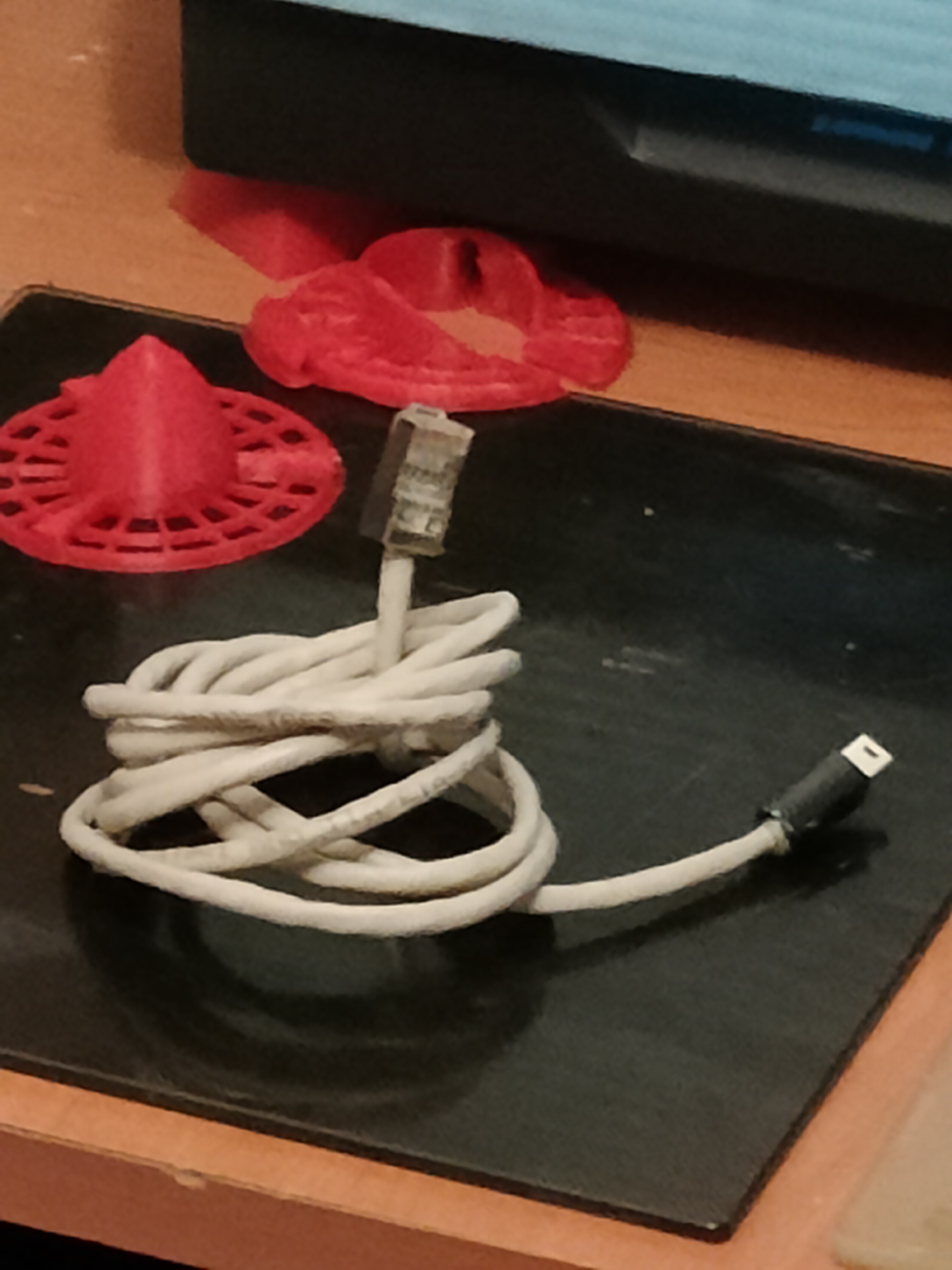

Cable plug my fifish v6:
