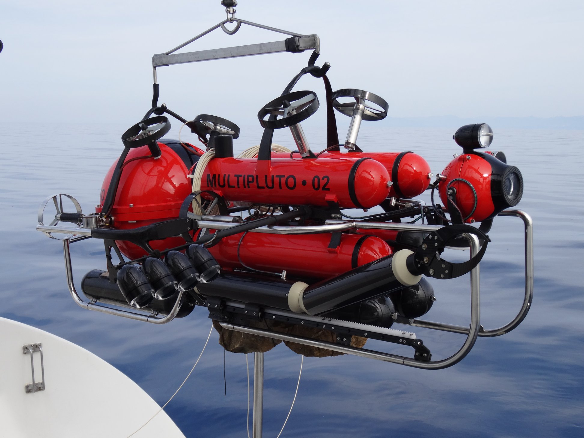

PlutoGabbia is a MultiPluto equipped with a docking frame to join the PlutoPalla (or another MultiPalla) and an additional coil of cable so that the communication coming from the surface along the main 3.5mm fiber optic cable once once it reaches the MultiPluto, it is also transmitted to the PlutoPalla via the secondary cable.
