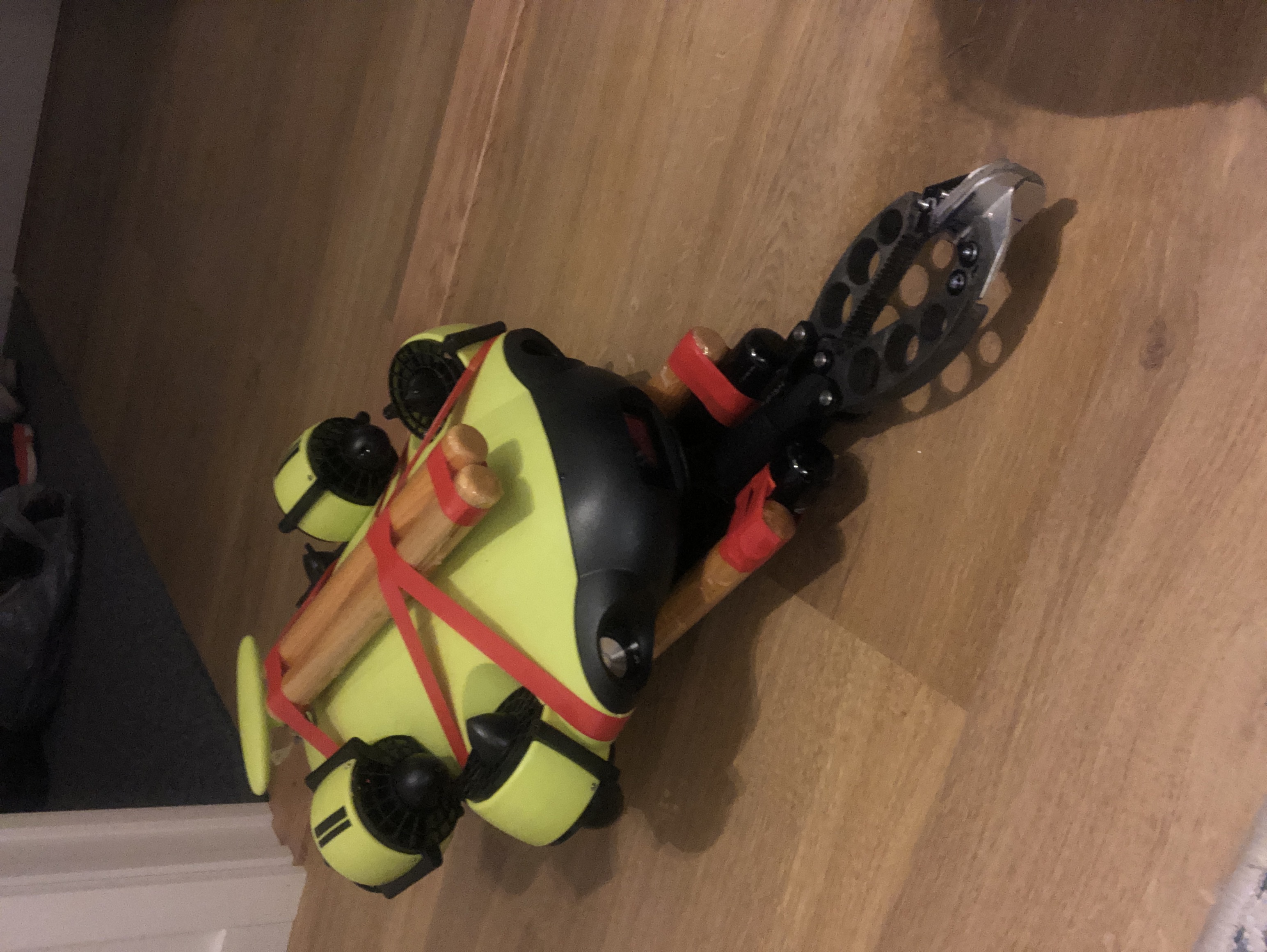

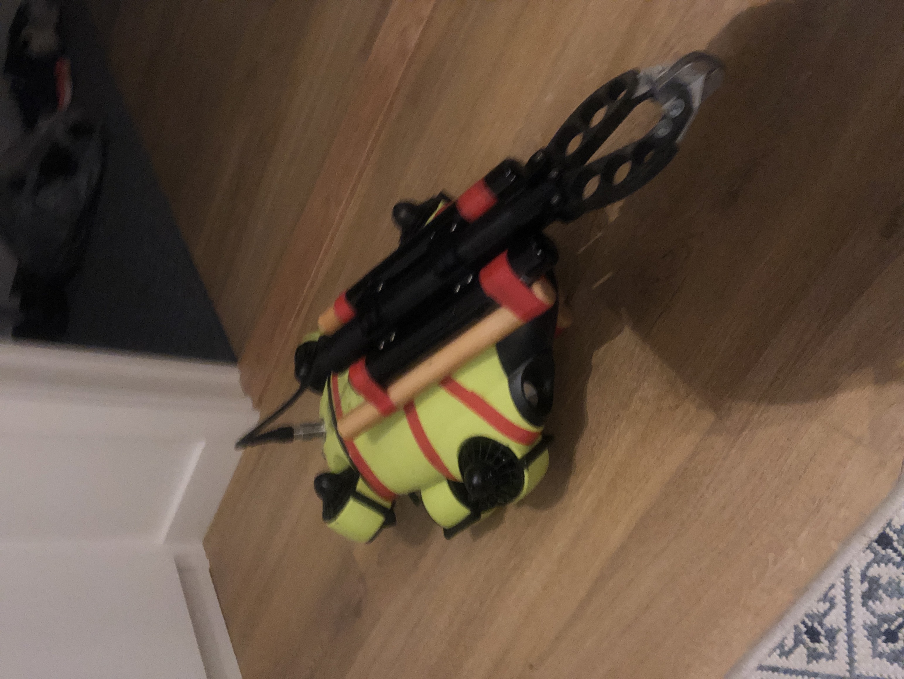

2. As a temporary solution, I purchased <Car door guard> and attached it. It is recommended that the rov have some positive buoyancy. Only then can you float on the surface.
* V6: 3.9 kg
* V6 s: 4.1 kg
* V6 e: 4.6 kg
The appearance and volume of rov have not changed. Qysea compared to V6 as it became heavier, design considerations for neutral buoyancy should have been taken into account. I should have added some buoyancy or something. I calculated some positive buoyancy to V6 e, which is 0.7 kg heavier than V6, and temporarily attached a sponge buoyancy material.
3. Additionally, it is difficult to put the rov on the floor out of the water.
Rough road surfaces such as gravel, rock, sand, etc. may be scratched or damaged. Qysea should have thought of something that could mount the rov (like a helicopter leg). It would be good to consider adding a cradle as an accessory. (Sponge does that role temporarily
