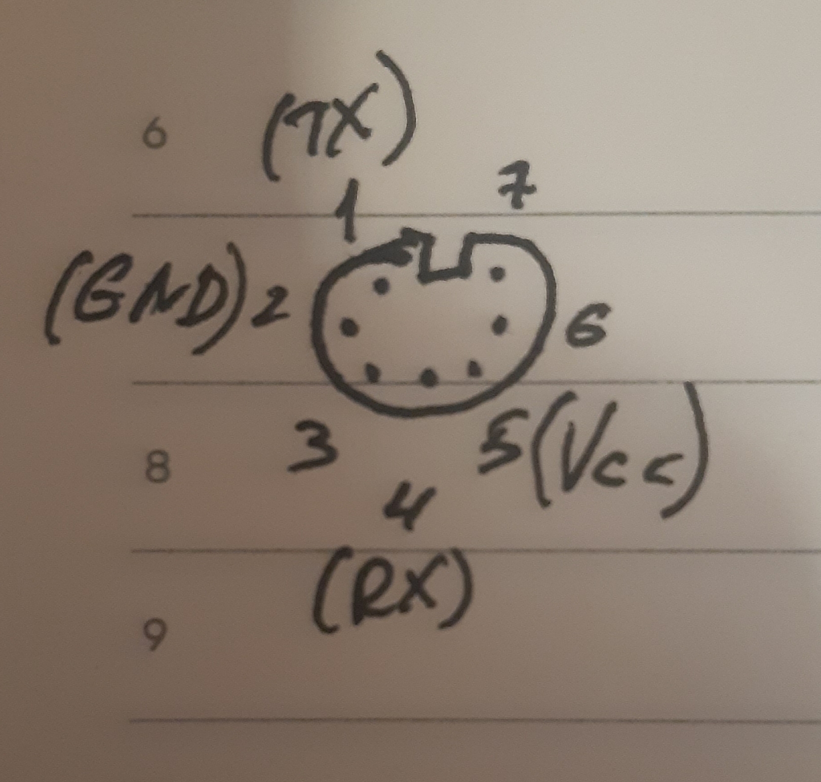

I'm trying to decide between the V6 and V6S, the gripper looks very useful.
I was wondering if anyone could confirm if there are unused wires in the tether that could be used to control a home built gripper? The cable has a 6 pin connector at the rov and I believe it's just a 3 conductor connector to the controller, seems like it would be possible to modify the ends and borrow a couple wires if it has all 6 conductors in the tether.
Zhenya88
New member
Default yellow cable in v6 have only 2 wire (rx/tx)
Connector have 7.
