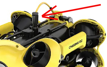

You may want to try wiggling the connection point(tether) on top of the M2 when it's connected and on, does it lose a signal at all? My connection point is a bit weak even if I screw it on tight, if I touch it there with too much muscle, kind of press against it, loses a signal. I'll eventually have to fix this I suspect, but it's not a major problem for me when driving it.
