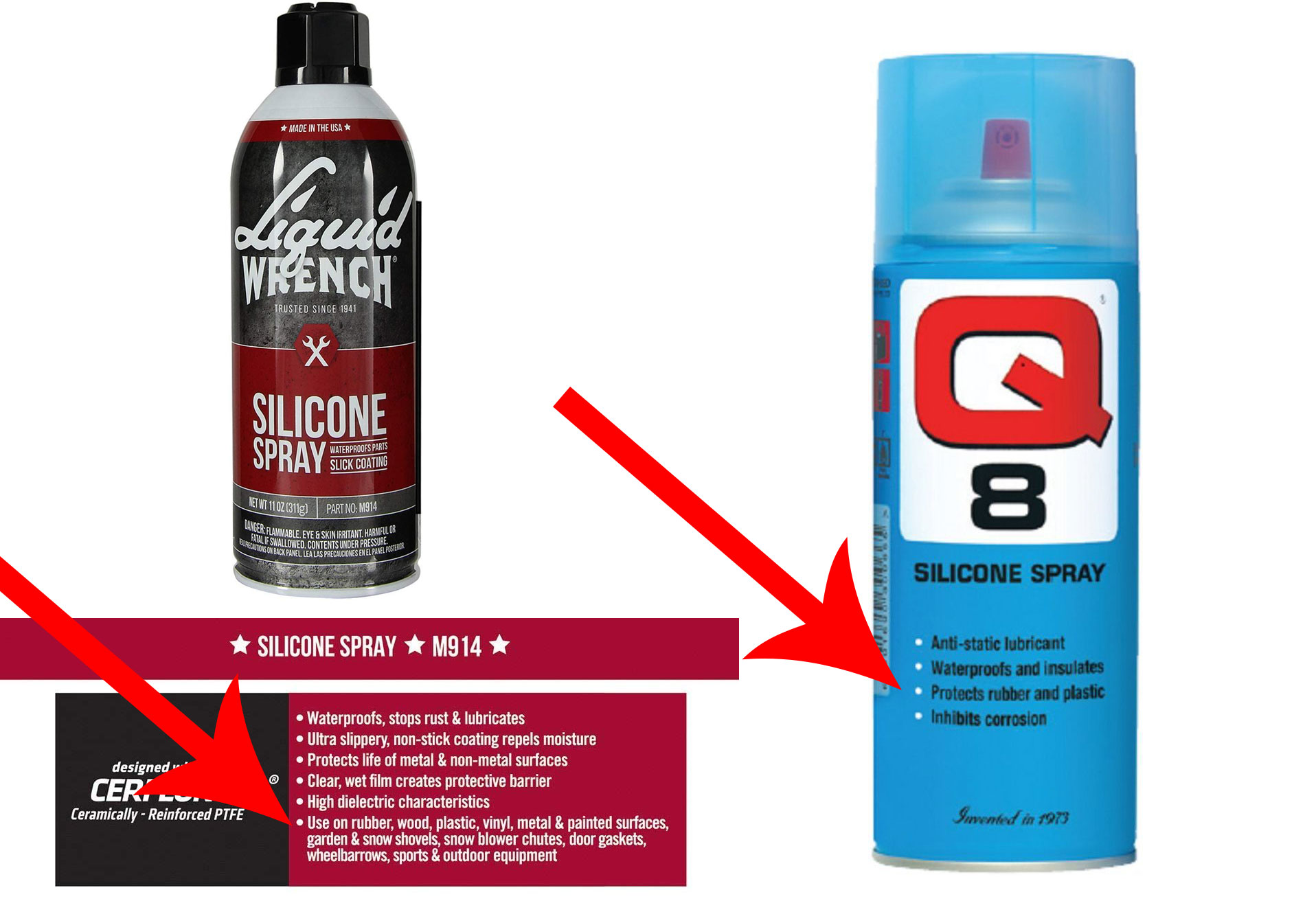

silicone-spray-underwater-drone.jpgI've used the Liquid Wrench brand of silicone spray on the Geneinno T1, seem to work pretty well. A great way to test the silicone spray, is to use some leftover plastic from something you're willing to throw away, spray some of the silicone on the plastic, let it sit for a few hours, if it doesn't eat away at any of the plastic, you're good to go!
I'm not sure on the whole oil and spray comment from the RC Universe forum, as most the silicone cans on the market say "spray" on them, even the brand everyone uses, Q8 says spray. You definitely want to look for something that says "protects or use on rubber and plastic" on the can, which not all of the silicone sprays do, but Q8 does! The Liquid Wrench brand also says use rubber, plastic, and vinyl.
