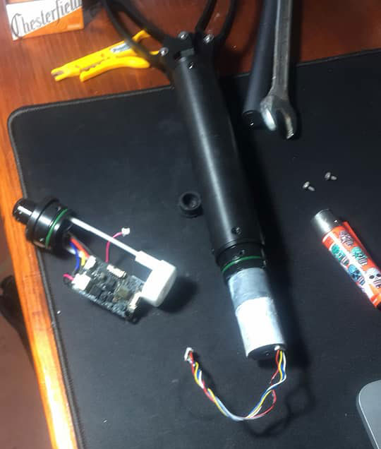

So after seeing a couple claws leak and cause short circuits on both the Chasing M2 and Fifish V6s underwater drones, I did some thinking, what if there's some type of extra protection we can add to the outer part of the main shaft of these grabber arms to prevent them from leaking, which in return would prevent any short circuiting from happening so often, basically extending the life of these claws? I mean with time, through typical wear and tear, I think most of these claws will eventually leak. With the claw bumping into things from time to time, picking up heavy or stuck items from the bottom of the ocean, my assumption is that shaft is going to flex, causing these o-rings to lose their sealing ability. I'm just constantly thinking ahead, considering underwater drones in general have a lot of maintenance to them. I mean, the majority of owners are using silicone spray to extend the life of the motors on these underwater drones, what if we all could do something to extend the life of these claws?

You could also fill the whole thing up with dielectric grease or petroleum jelly. That is also nice to use in the electrical connections as it prevents oxidation/rust. This will leave a lot of sticky residue if you ever want to remove it :)

Heard a few Chasing M2 owners complaining of their motors locking up after using them, just like fishing reels that are used in saltwater, they need rinsing every day and re-oiling/re-greasing every week or so, underwater drones are no different. I personally think you have to do everything you can to extend the life of these little gadgets!
