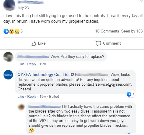

Here's two reports, I guess you could say the first one is kind of understandable considering the owner said he used the FifishV6 everyday. But another owner said he worn down his propeller blades just within two dives!!! That's totally unacceptable, I've seen what Stan Adam/Stans Legacy said bout his Gladius Mini, despite having 200+ dives his propeller blades are perfectly intact. I think he said at one point he had a motor replaced, but so far it's been a pretty resilient underwater drone.

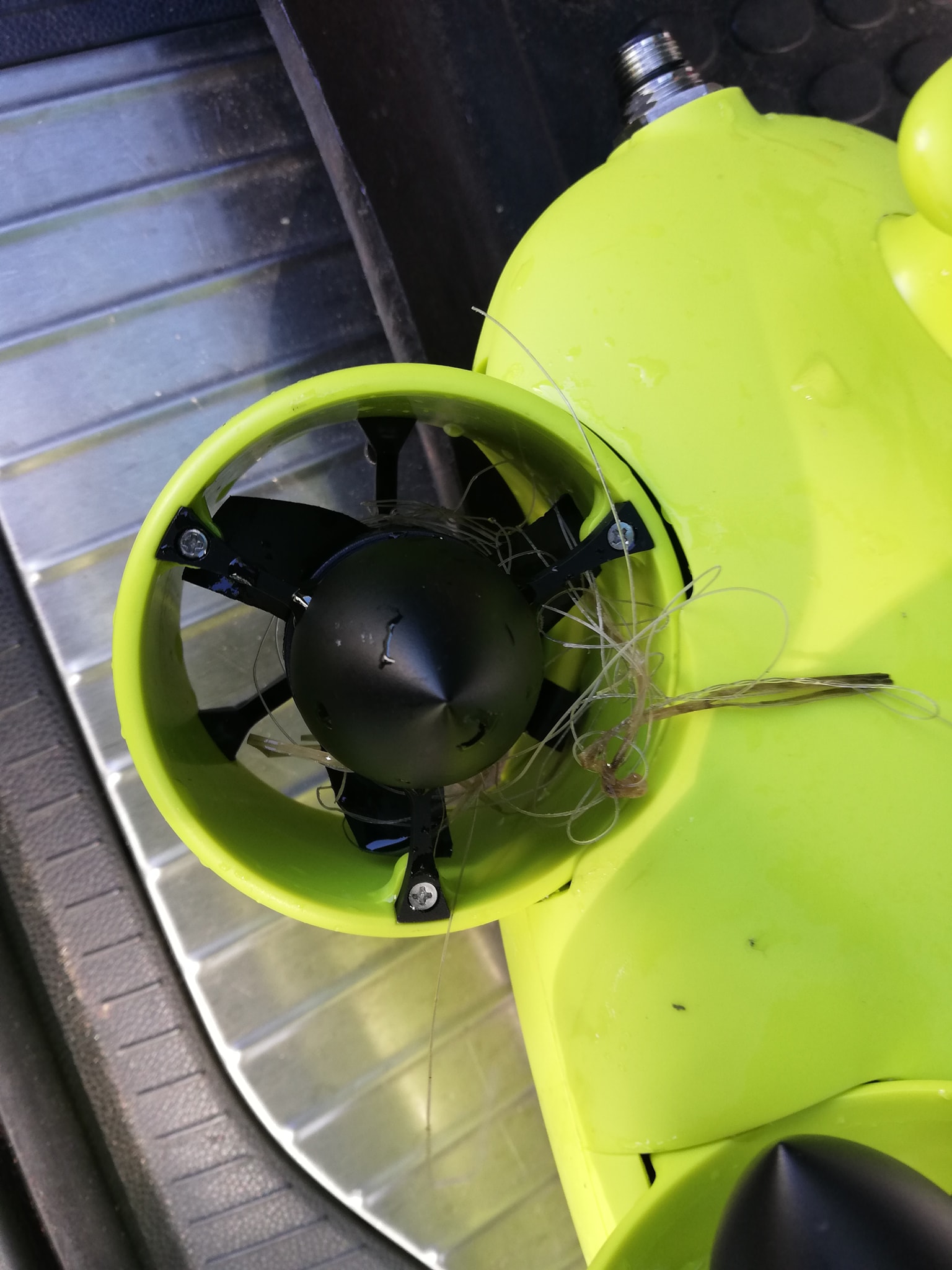

There was another report of some fishermen on YouTube named OriginaldoBo that reported damaging their thruster motor after the Fifish V6 ran over some fishing line. That basically could probably happen to any underwater drone I'd say, but I suspect some ROVs thruster motors and propeller blades are just tougher than others, I wonder if some might just slice right through the fishing line, it really probably depends what pound test it was. It being saltwater and the sea, probably pretty darn thick.
So just be careful out there navigating your underwater drones, you just never know if some monofilament could be laying around on the surface or even on the bottom attached to a lure. Fluorocarbon is even clearer than monofilament, which is a little scarier, it's known for it's invisibility for fishing.

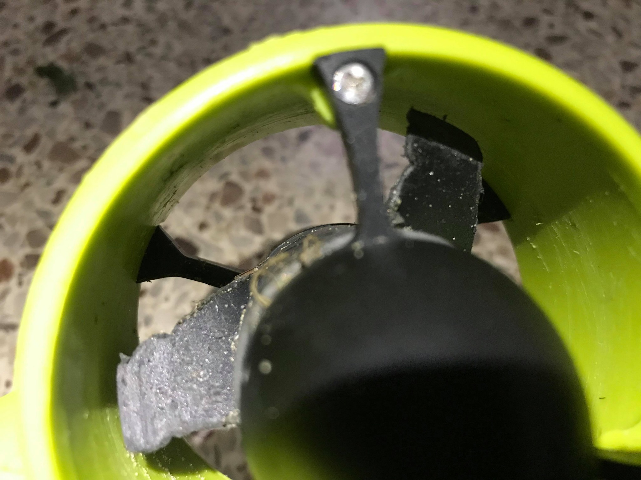

Following my first dive with the QYSEA V6 I managed to badly damage 3 propeller blades on one thruster ( see attached photo) and one blade of two other thrusters. The seller is sending me a full set of propellers. I would like to fit the thruster protectors when they come available.

Wow, worn all the way down, crazy. QYSEA needs to upgrade the plastic material they use, thank you so much for sharing Dave. I'm sure they'll sort out this problem with the newer models coming out such as the V6+ and W6, I'm glad they responded quickly with protective covers for the Fifish V6.
The seller said the damage was done because I did not calibrate the drone before putting it in the water even though there was no mention of calibration in the quick start guide. Also the compass in the bottom right hand corner was reading correctly and the indicator in the bottom left showed correct orientation of the drone.
Instead of making excuses, QYSEA should be fixing the problem, which is trying different material they use for the props or by making the propellers thicker, not blaming the owner for not calibrating.

I hope the new blades are a lot stronger than the original ones, they arrive tomorrow. I also ordered the protectors which will arrive on Tuesday. I will keep you updated on how they perform.
