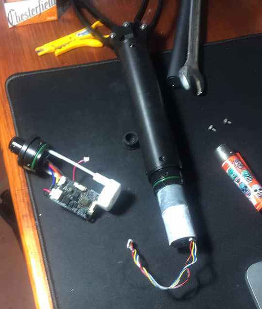

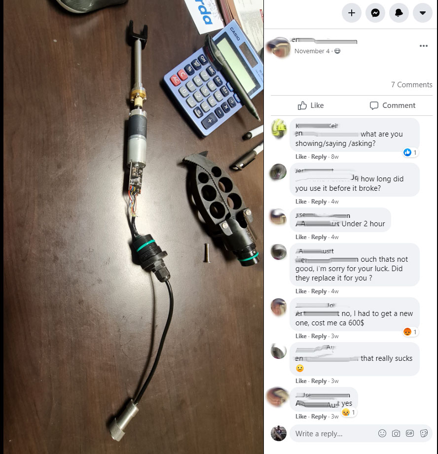

I really think this modification could definitely help extend the life of your grabber claw on your Chasing M2. RC Car and boat hobbyists use Plasti Dip all the time to seal off their circuit boards like a servo and receiver. The problem is with any type of electronic that goes in the water, with time rubbers gaskets can deteriorate from salt or long time use in even freshwater. Even when the grabber claw is picking up heavy items off the bottom, the claw's shaft can bend a little and cause leakage at the gaskets. It's already happened a few times with both the Chasing M2 and Fifish V6s grabber claws.
Chasing M2 Leaking Claw
Fifish V6s Leaking Claw
